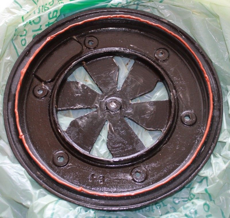

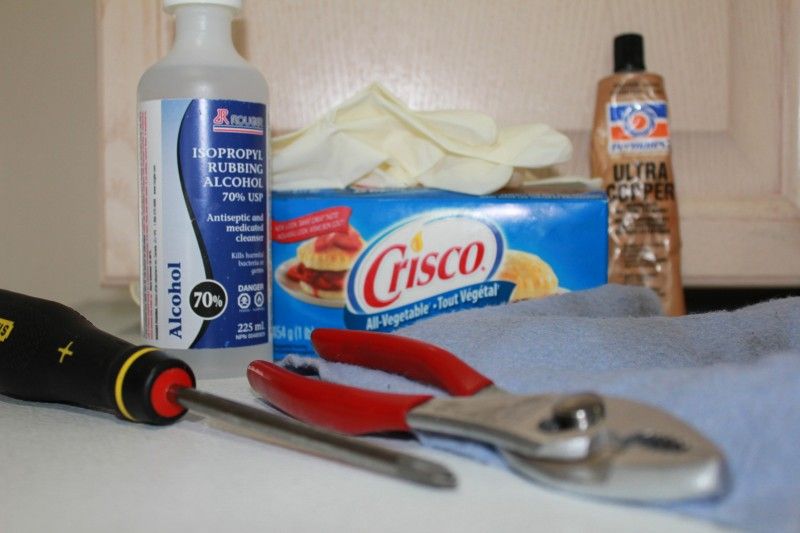

          Seasoning:
          • Put solid/spray-on Crisco or Peanut/Canola oil on the top vent and Cast Iron (CI) grate.
          • Fire up grill to 400* and let it run for about an hour.
          • This will get rid of any factory sealants and season the cast iron parts.
          What to look out for during seasoning process.
          • Leaks are possible just simply due to the mass production of any grill.
          • Typically around the lower or upper vents and also around the lid gasket is where you will see leaks.
          • High heat silicone will seal up the leaks at the bottom vent.
          • Seasoning and running the keg will help with the top vent.
          • The gasket may require a break in period.  It may leak a little but over time it should diminish.

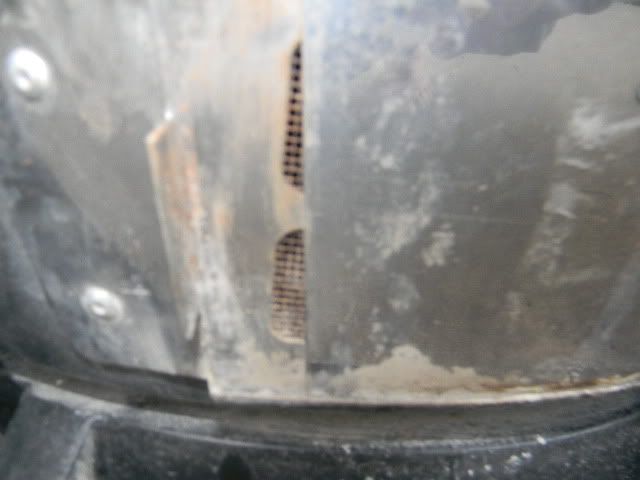

          Some users have also sealed the lower vent as seen below:

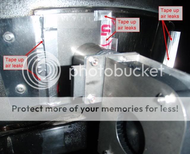

          I knew my lower vent needed some sealing and also I wanted to seal the area between the inner liner and the vent/outer liner.
          I'm going to give some low and slow temp control dry runs a try.  So I vacuumed and cleaned out the lower inside and the inner liner while I was thinking about it, since I'd been doing quite a bit of cooking it the keg.
          The first picture is the without sealing.
          The second picture shows how I sealed the inner liner all the way out to the back of the lower stainless steel vent frame.  This should keep any excess oils from getting between the liner and outer wall and seal air leakage at the back of the vent.
          I used this

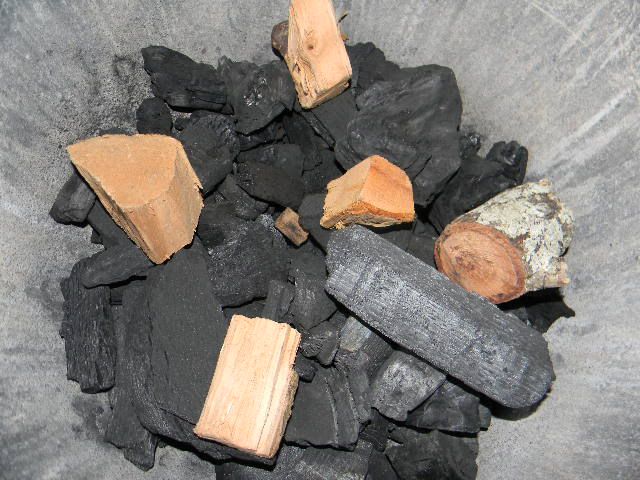

          I will attempt to help those starting out with the old saying a picture is worth a thousand words - the vents are a Bubba version but the mass area of open vent should be able to be translated to a BSK
          Load the keg with quality lump and your smoking wood CHUNKS
          Place a fire starter in the top middle light the starter lid open and bottom vent wide open and let it burn out (10 min or so) This lump is a mix of True Que and Winn Dixie (WD is on sale 5.69 thru Tuesday for those central florida keggers I bought all that Longwood had)

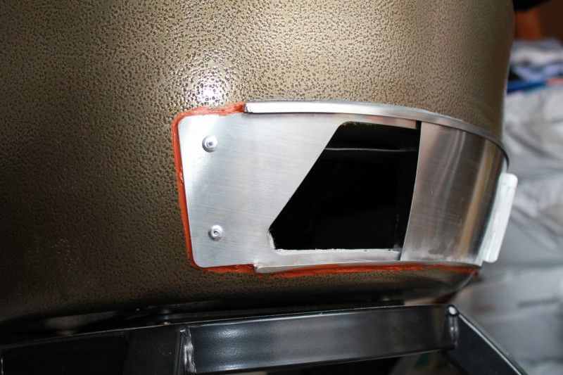

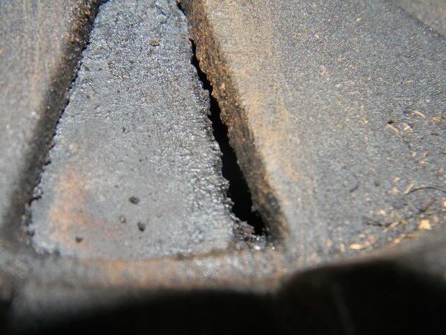

          Set bottom vent to this and you may have to shut it more (I do usually after an hour and a half or so)

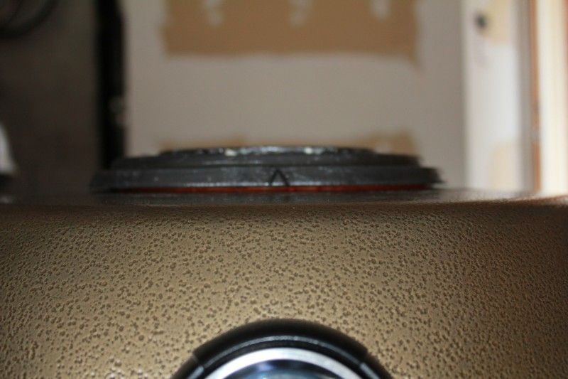

          Set top to this
          This top vent setting is for all low and slow as well as pitmaster use
          Keggers there are differences in lump, kegs, ambient, humidity, fire starters ....... On fire starters you just want to get the fire started if you have big starters break or cut them to a piece that burns 8-10 min do a trial or two

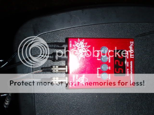

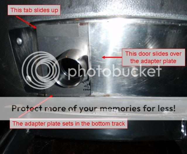

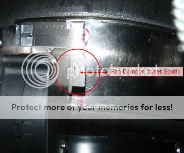

          Heat controllers:
          There are options for those that want extra piece of mind in over night cooks or who just like cool gadgets.  The two below are the most popular.

          Bonus picture!
          I originally took this picture to show how much I was restricting the Pitmaster airflow (pre-flat washer mod) but you can see the port in the background.
          Taping up the air intake area for fan adaptor:
          Hey all,
          I just purchased a BBQ Guru for my BKCG Cool  I went with the DigiQ II, 10 CFM fan and BGE XL fan adapter plate.  The 10CFM fan and fan adapter plate were recommended by folks at BBQ Guru for the BKCG.
          I thought some of you might want to hear how the first few test runs went.  Please forgive the poor pics.  I was doing the test runs this week at night.  Ill try and put something better together later.  This is just sort of the 1st quick and dirty
          Well I read the Guru manual cover to cover several times and all the setup/startup and how to posts on the BBQ Guru website.  With all the reading on the Guru I thought Id be up and smoking with just one or two tries Grin  but it took just a bit more  Huh
          1st try:  cleaned the fire box up real good and put in enough fresh lump for a easy 4-5 hour run at 225-250*. Installed the fan adapter plate.
          Lit the lump top/center with one small fire starter stick and let it get going for a few minutes.  Closed up the BCKG and set the top damper just on the narrow side of #1.  Thats just to make the Guru work a little (per instructions). Kicked on the guru to let it bring the BCKG up to temp.  Dialed pit set point to 200*.  All seemed to be going well!  Nice regular warble to the fan and the temp climbed steadily to the set point (maybe a bit to fast).  Once 200* was reached the fan stopped and temp continued to climb.  I stopped the test at 230* Sad  Note: the fan damper was fully open.
          2nd try:  Same as above with fan damper at 1/2 open.  Results were the same, but I noticed air leaks around the fan plate adapter.
          3rd try: Same as 2nd but taped up the possible air leaks at the fan adapter plate. Results were the same Angry Some frustration starting to form at this point
          4th try:  Same as above with fan damper at  open.  Steady fan warble, but the BKCG never reached set point. The fire went out.  I dont know, it was getting late.  I could have rushed it and not had it lit properly. Undecided
          5th try and 3rd night!  Same as above with fan damper at 1/3 open.  Slowly reached set point about 15/20 minutes and seamed to hold  Wink  After 30 minutes I raised the set point to 225*.  The grill got to 225* in about 10 or 15 minutes.  After an hour it was still holding.  Checked it every 30 mins for 2  hours and it never moved more that 1 degree!!!  Dome temp displayed about 10 degrees warmer than the Gurus grate temp and that sounds about right to me.  I think I got it Shocked
          The sweet spot on the fan damper seems to be very narrow, but this is my 1st Guru and Ive only done just these few tests.  Ive still got a lot to learn, so its off to the store for some large chunks of meat!!!
          Ill keep you posted!!
              The BBQ Guru adaptor you want to select is the EXTRA LARGE BGE adaptor.

            Sealing a Keg
            How to seal the top and bottom airflow dampers.
            Tools and materials:
            -Phillips screw driver
            -Hex key (5 mm)
            -Flat-nose pliers
            -Clean cloths
            -Soap and water
            -Rubber or latex gloves
            -Rubbing alcohol
            -High temp RTV gasket maker
            -Vegetable shortening (optional)
            Time: Two hours
            1. Remove top airflow damper and base.  Season inside and out with vegetable shortening if you have not already done so or it has been awhile (this will further seal the keg and prevent rusting).
            2. Clean the inner ridge of top damper, keg lid and wall just around the top and bottom airflow dampers (using a clean cloth and rubbing alcohol and / or soap and water).
            3. Apply a thin bead (2 mm) of RTV gasket around the bottom airflow damper as needed.  Work into the gap between damper housing and keg wall.  Wipe off excess with a cloth.
            4. Apply a bead (2 to 4 mm) to the inner ridge of the top damper as shown below.  Carefully reposition top damper base (make sure airflow indicator arrow is at the front) and replace screws but do not tighten.  Wait one hour then gently tighten the screws to snug.  A half turn should do.
            5.  Finally, complete the reassembly of the top damper by aligning airflow indicator and securing top damper with nut, lock-washer and bolt.
            Wait 24 hours (under normal conditions) for the RTV gaskets to cure.  If you seasoned the top damper in step 1, remember to fire up the keg to 400 degrees Fahrenheit and hold that temperature for one hour.
