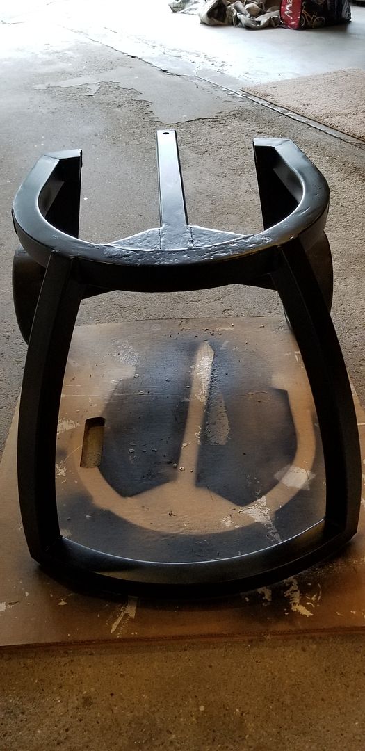

First task: getting it off the stand! Some liberal sprays of PB Blaster and some whacks with a sledge and 2x4 finally freed Bubba from its stand. Ya know what? It doesn't really look that bad. Some pics -
The stand: (no wonder it wouldn't release Bubba)
I think some effort with a wire wheel and Rustoleum should take care of this.

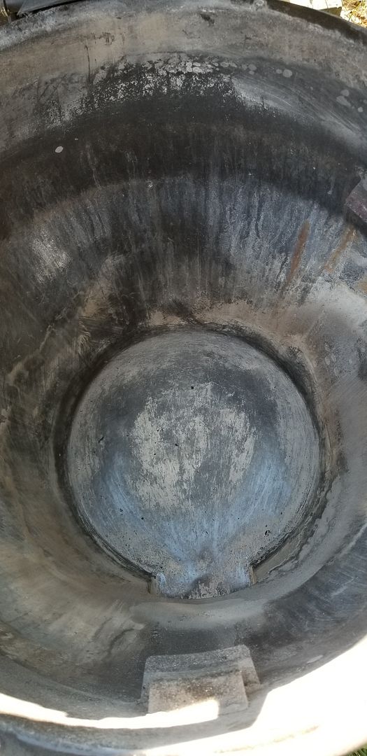

The inside of Bubba:
Here's where I was most surprised. I was expecting holes right through the bottom but this thing is almost pristine.

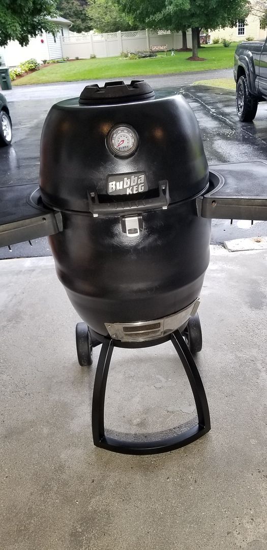

Bubba:
Needs a new coat of paint, I may just go with black to match the Golden's Cast Iron.

I fabricated some aluminum pieces to patch the rusted areas around the lower vent. They're riveted in place and there's some additional JB Weld High Heat epoxy helping to patch the holes. There's a build thread over in bbq brethren, but here are the final pictures of Bubba V2.0. Now sporting a black exterior.
Should be ready to go a few more years.

Interior, not all that bad -

Stand, after some work with an angle grinder and painted -

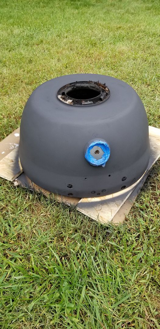

Lid, with base coat of high temp bbq paint. Bubba is being painted black to match the Weber and the Golden's -

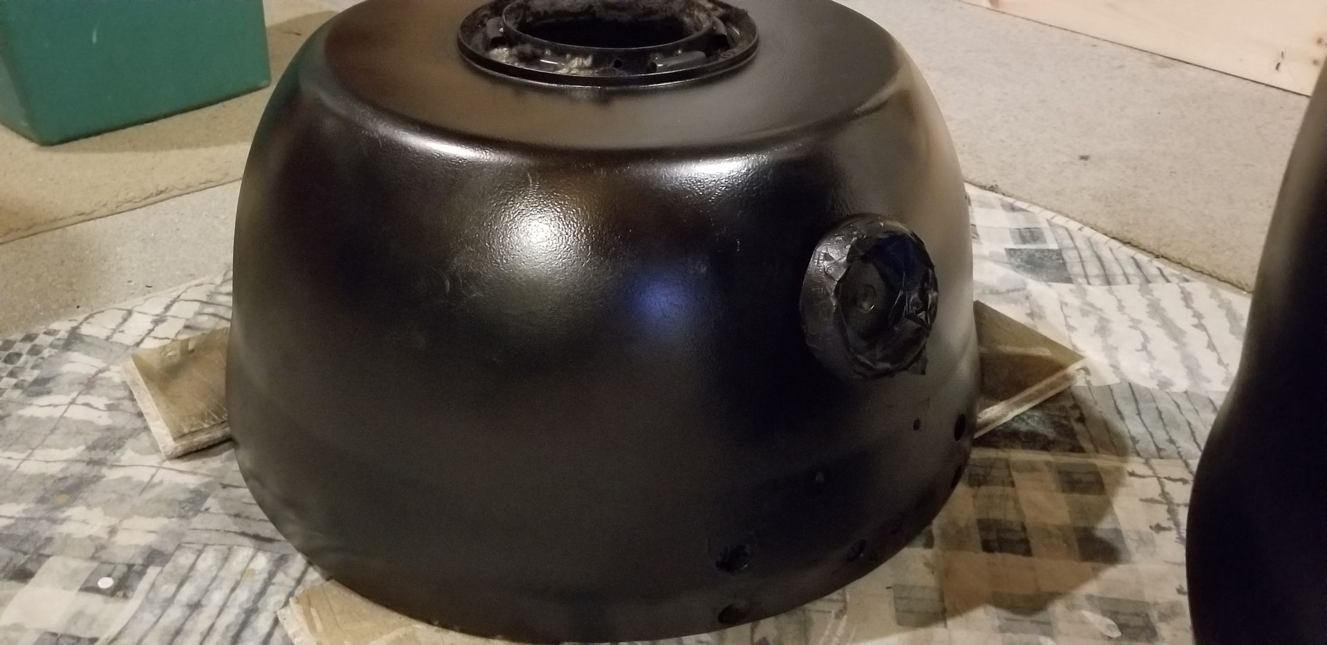

Final coat of high temp auto enamel -
And it's back together and ready to grill -

« Reply #10 on: September 14, 2018, 07:36:16 AM »
Bubba Smokes Once Again
It's good to see smoke coming out of the Keg again -
No leaks around the gasket, which is great. And the bottom vent seems to be doing well also.
