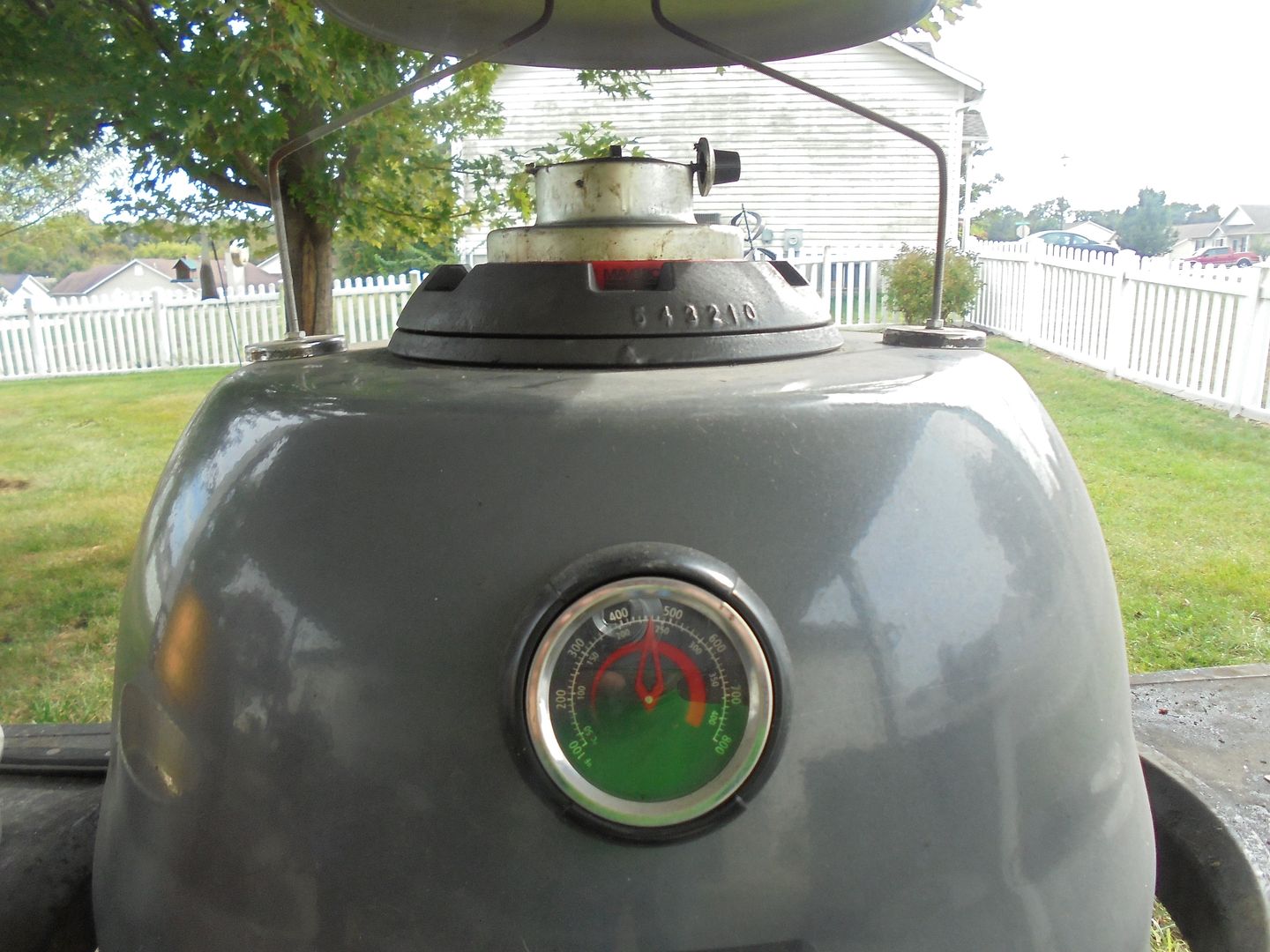

Have you needed to change out the magnets that secure your TTT to the top vent on your KEG?
Walter
No, still using the same one's.
