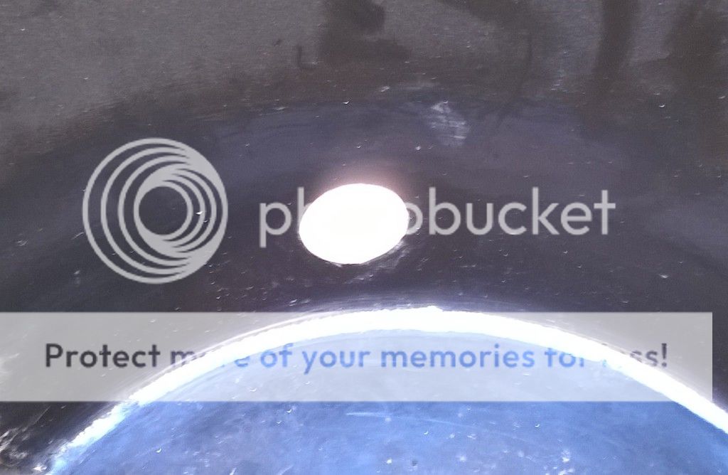

Here is a shot of the hole drilled:

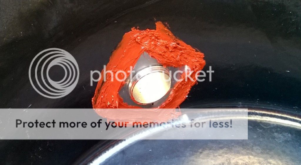

Shot of the inside of keg with the bulkhead adapter installed and high temp sealant applied all the way around the square adapter nut:

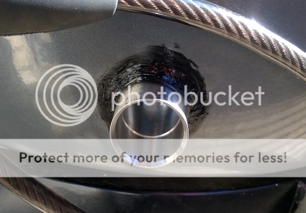

Shot of the outside of the keg with the adapter installed and sealed up with black sealant:
All in all, not a bad install. Took about 30 minutes total. Just wish the bottom vent setup on the BK5000 was setup like the 2000 so I could have avoided having to do this to use an ATC. Can't wait to give it a go in the next couple of days.
« Reply #7 on: October 08, 2016, 04:08:09 PM »
Are you wondering a bit whether the red high temperaturr silicone will be able to withstand the heat emitted by the charcoal on the inside of the Keg?
The outside black silicone should be no problem.
No I have no doubt it will hold up. I was wondering if the ash drawer itself being a static object would mess up the air flow in any way coming from the blower and possibly cause ash kick up or bad circulation.
