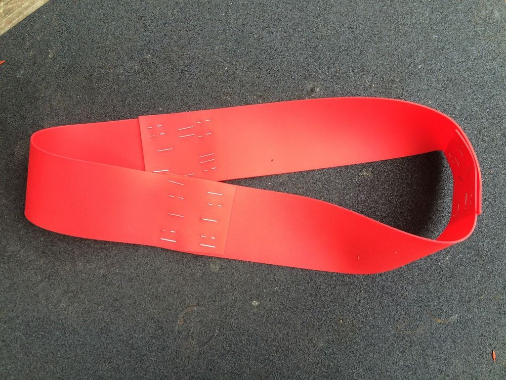

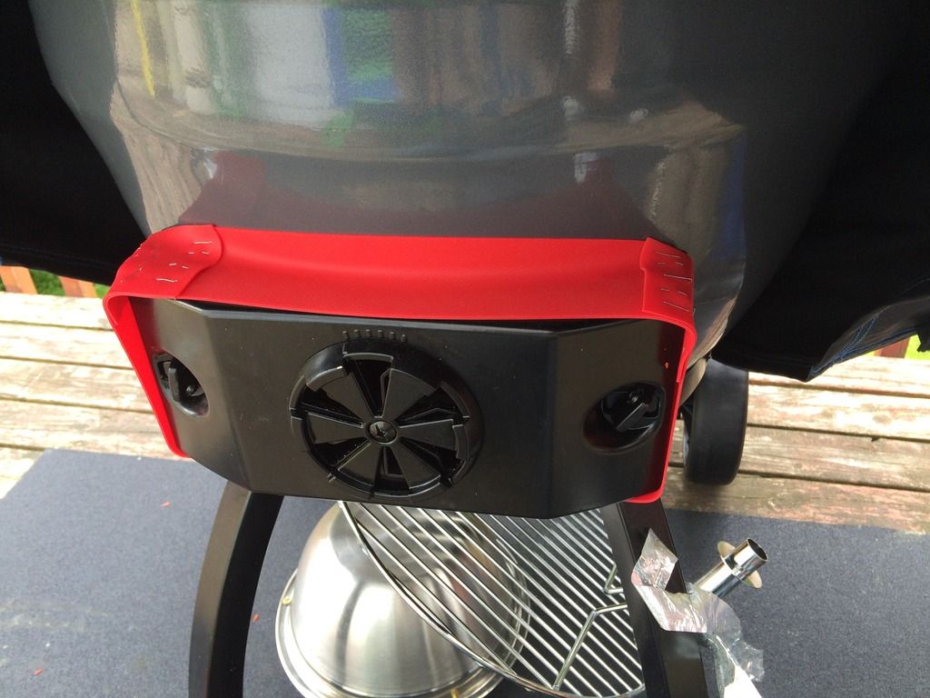

I tried to use red high heat silicone caulking to solve this issue, it was not super successful. I pull it all off and tried an other approach. I bought a cheap silicone baking sheet and cut it into 6 cm strips. (2 1/4 inches basically) and for simplicity (and lazyness) I held the strips together with a staples. I made it about 3 cm (an 1 inch and 1/8 ish) shorter than the circumferance around the ash tray. The silicone I have is elastic so it easily wraps around with a bit of tension. Think a large rubber band made of heat resistant silicone.
Installed on my 5000.

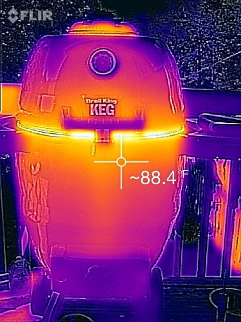

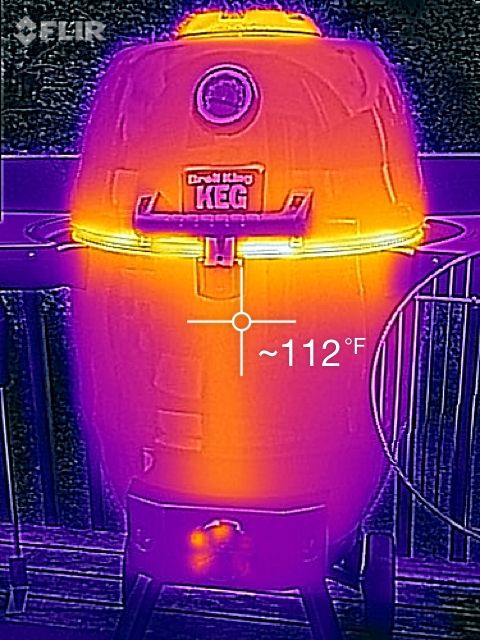

Some may have seen my thermal images I have before and after thermal shots
Before
After
It looks like an improvement to me.

 I too feel there is air leaking in from the tray seal. When I close it up to force the fire to die, I still get smoke from the ash tray toggles, in my case I had issues with the fire burning for some time after all the vents were closed, I no longer have this problem. For my purposes I believe the band is a reasonable solution. Simple, low cost and still allows the function of the design to work.
I don't think staples are the right solution. They are a temporary prototype method. I am looking at glue or adhesive methods to replace the staples. I'll keep you all posted when I find something.

The band is working quite well there is a little wisp from the toggles and from the top vent between the two layers but that seems to be it. I have still not tried the goop to hold the silicone bits together but soon.

Update I have used the Sugru to 'glue' the sections together. It has altered the elastic and flexibility at the seams. I it is better than being stabbed by staples but i am not sure it is an over all improvement just solved one issue but created another. I am still working on a better one.
